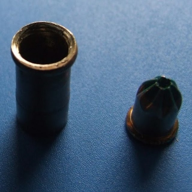

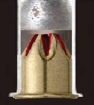

*.32 Colt Brass (Drill 17/64" through the primer pocket, then countersink case rim with 21/64" until Ramset rim seats flush with case rim.)
*.27 caliber Green Ramset blanks (Use as is, or refill with your choice of powder.)
* Lead roundball 50 grain or sized LRN 90 grain (Roundball use with .27 caliber Green Ramset as is. If using LRN subtract powder by 0.2 grains.)
* Depriming Tool (Modified 5/16" fuel line fitting. With case inserted from the bottom clamp the fitting and deprime ramset blank with solid dowel.)
