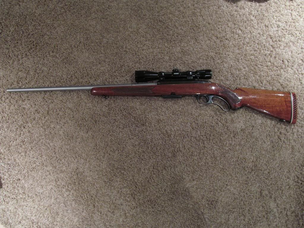

Yeah that is what I have been told. Here4 is a pic of the gun. Was hoping to find someone who has had the caliber. Thanks for the help.
I have 1. Load data varies by action/bullet length. In your case with the o.a.l. being determined by mag. length. The setup you have won't support the long bullets. They will be far into the case and eat up powder room. Bullets of <200gn. will be best. Handgun bullets as well. I used the lower end of the 35 Whelan data to start, then worked up to the same as max loads. Mine is a Ruger bolt action. I can load most bullets long. Mark
I picked up some hornady 200 grain bullets today that should work well. I was thinking of using 225 sierra's but put them back thinking on how deep they would have to be seated. I have a few 180 grains that came with the gun. I am using some handgun bullets to fire form the brass. What length do you trim your brass too.
