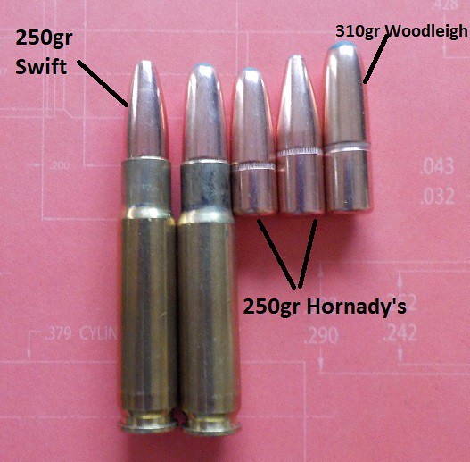

Developed an accurate load for my 358 BLR takedown with Hornady 250gr RN. Following Hornady Handbook 7th edition using a near maximum charge of Re15 I get 2140 fps muzzle speed (chrony positioned 7m from the muzzle). The rifle used in the Hornady Handbook was a T/C Encore with a 24" barrel and maximum muzzle speed is 2300 fps. So with my 20" barrel BLR muzzle speed is about 100 fps less.
