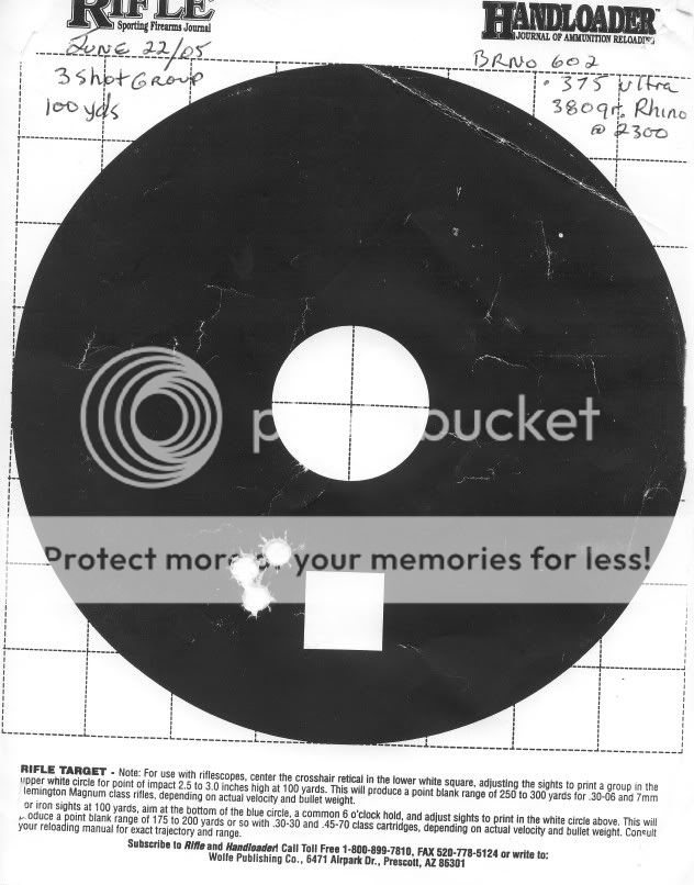

When I was looking for a replacement of my .416 Rigby, I considered then rejected the .378 Weatherby due to the cost of the brass, and went with the .375 Ultra. At the time I had my first .375 Ultra built, Ultramag brass was going for a bit less than $1/ea while the Weatherby brass was more like $2/ea. The .378 produces an additional 100 fps relative to the .375 Ultra with any given bullet weight, but I doubt that I could exploit the advantage. I wouldn't be concerned about the recoil of the .378 Weatherby if you're used to shooting powerful rifles. I was able to hold 3 rounds prone with a hot loaded .416 Rigby, but usually found the 4th round unpleasant, where the .375 Ultra 5 rounds prone were manageable, and 3 shot groups even with a 2X scout scope were pretty good.
