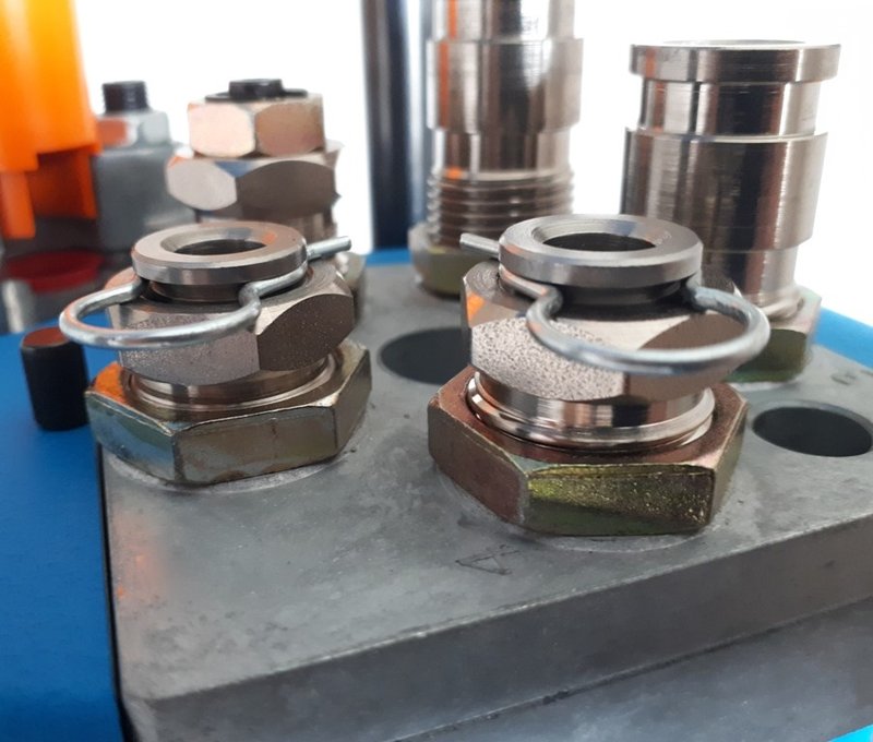

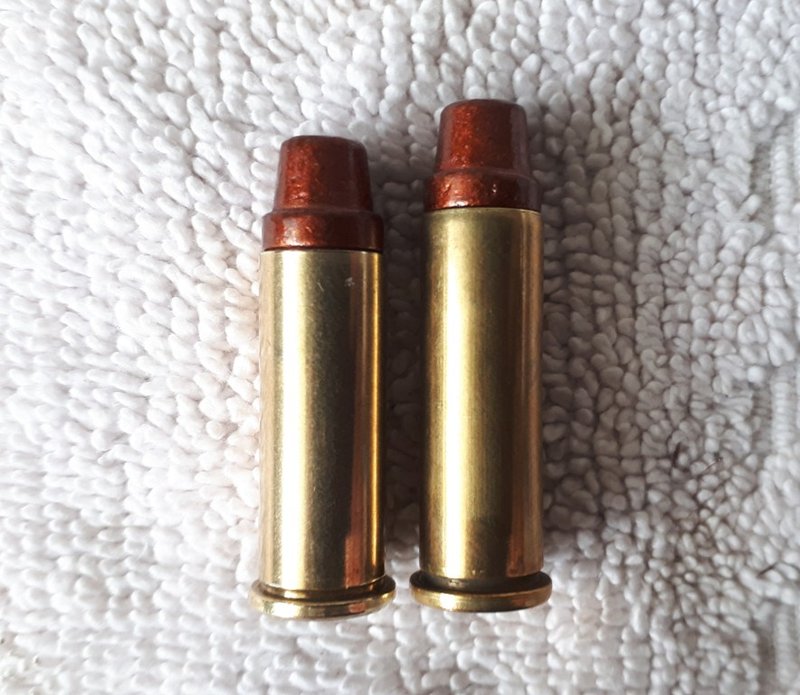

Dillon .38/.357 dies, on a Dillon 650, will fully seat and crimp .38 Long Colt. I trimmed .38 Special brass to 1.03 and loaded a dummy round using a 158gr SWC seated and crimped to the groove. The seating die still had quite a few turns left available to it, but the crimp die is right at its limit (ring on top and without any modification). I probably couldn't get a "strong crimp" but I don't need or want one. The crimp measured at .377 and that's plenty strong enough for me. I'm basically using the roll crimp die to just de-flare the case mouth. I won't be able to load some real rounds until my press gets fixed (I just received some alignment tools from Dillon today). As to why? For me, it will hopefully provide easier ejection, powder conservation, and I can repurpose .38 Special cases which crack at the case mouth.
Left: .38 Long Colt, Right: .38 Special
Left: Crimp die setting, Right: Seating die setting
