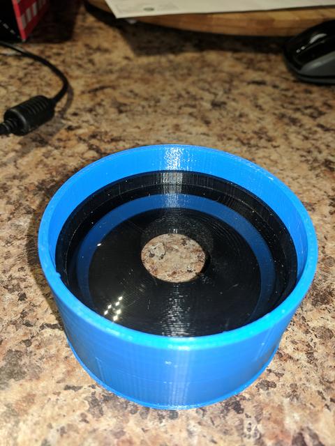

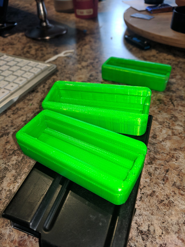

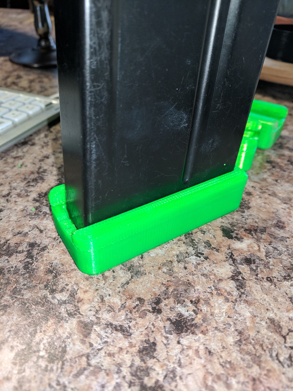

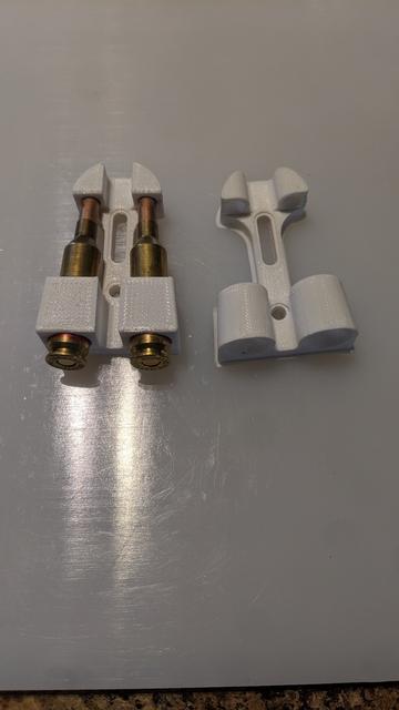

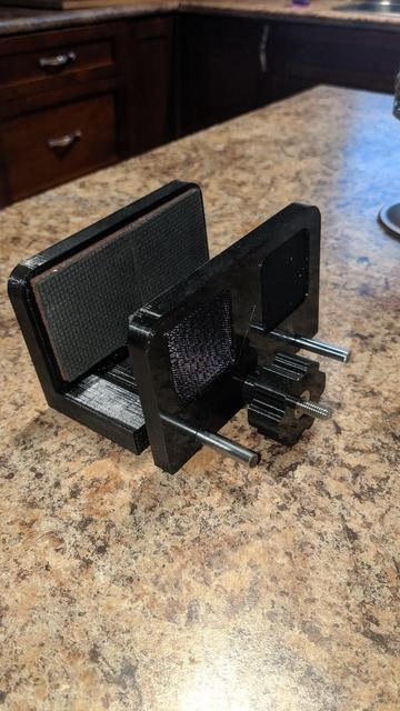

Here is a rifle clamp for shooting from a tripod, just finished a prototype. Few other projects as well.
Match Savers
Mag Extenders
Indoor training scope adapter (IOTA)
