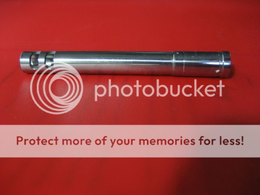

Epps has a proprietary caliber (made from .30 rifle barrels, I believe) that seemed economical, though there are no commercial loaders or reloaders for the cartridge, which would really give the new caliber and conversion some momentum. THAT is a simple barrel change, though there may still be idiotic demands to relabel the slide. I would get some professional (metal) stickers made up, if I were Epps, and ship them with the barrel, to deal with the marking issue.
