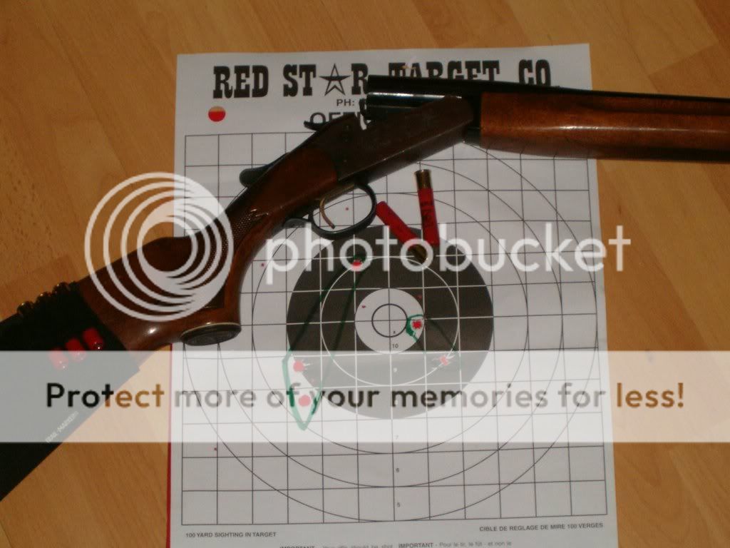

My wife has finally agreed to learn how to shoot a firearm as I'm away from home quite a bit. Due to her small size and lack of knowledge she is going to start with a single shot 410 shotgun. I loaded up some buckshot loads and thought you guys might be interested in the range report. The first load on the right of the target contained two OO buck pellets and a small amount of #6 shot to keep them from rattling. The load on the left contained three OO pellets. Both loads were fired at 12 yards. At 25 yards the results were quite bad, only one OO pellet struck the lower left of the target and the other two went God knows where. So out to 15 yards would be the max range for these loads.
I would suggest trying some slugs instead of buckshot. They are a little expensive but will be a lot more accurate.
Very interesting, mcpiper. Thanks for posting the info in good detail. I'm guessing your choke size is Full? Which works best for buck shot in any gauge, but not for slugs (open choke is the best). Possibley for your wife's size and experience, maybe a light weight Ruger 10/22 would be a better choice. 10 rounds (or more with a bigger mag), no recoil, light, less muzzle report, Hi velocity HP ammo. Just my 2 cents, but again thanks for posting those 410 resualts.
I have sent many slugs through my Remington .410 pump and seen decent accuracy. It's a full choke and the recoil is no different with the slugs than shooting shot.

Try the same load but with 4 .375 roundballs, the larger pellets work much better for some reason. I get a 12'' pattern @35yards and all 4 pellets will penetrait a coyote at the same distance. Good Luck.
mcpiper
Sounds good I might try that in a 3" shell. Once I get her hooked on shooting I'll buy her something more appropriate. And regarding the slugs yes I do use them too, if you look close in the pic that's what I keep on the gun.
