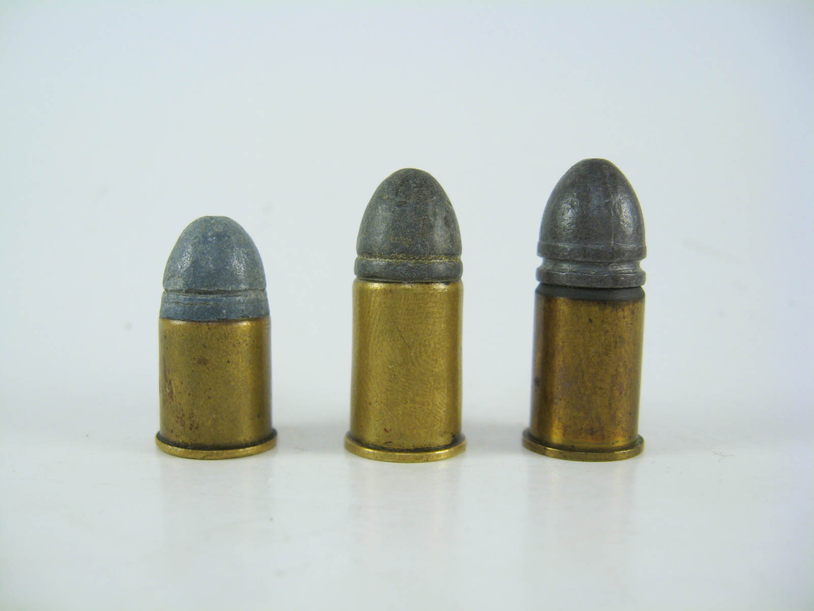

I have a 44 Webley, my understanding is that there never was a 44 Bulldog chambered pistol but 44 Bulldog was made as a short for a 44 Webley. There is also a 44 Webley with a .442 bullet (European) and a 44 Webley with an inside lubricated .429 bullet (American). Mine is an Iver Johnson, it has a .429 bore, .435 throat and it is stamped British Bulldog on the top strap.
.44 Bull Dog (Peters), .44 Webley (UMC) and .442 Revolver (Eley)​

I use cut down 444 Marlin brass, fits like a charm. But there is no throat in the cylinder, by the time a PL bullet hits the bbl it's upset to the cylinder diameter. Then the bullet must shave off a ring upon entering the bbl.

All of these are all over the map, mine head spaces great with full thickness rim for a 44 special but the standard 44 webley and 44 bulldog I bought at a gun show have way too much headspace.
Your gun does not make sense to me for a 44 in any respect, the inside lubricated 44 is about .429 and the heeled 442 is .442. Your throat being larger than your muzzle is correct but a taper like that in the cylinder is weird for a 44.
Yea, I think I will get the .442 heeled bullets from Jethunter as I think the cylinder is built that way to start forcing the heeled part down before hitting the barrel, there is an integral bevel in the frame/ barrel which is basically the forcing cone(I think) and that is hopefully where the rest of the heeled bullet swages down to the barrel size. I will try a couple just tapping them through the cylinder and barrel first to make sure it will work.

Found this pic (located in post above )on the net explaining the Iver Johnson American and British bulldogs. Just simply a choice of name you wanted. Came in 44 Webley or 44 Bulldog Interesting! i have one of each.

It is not just the name, the name and the year means something. Iver Johnson only stamped British Bulldog on the top strap of the First Model between 1878 and 1882, which helps to prove it as antique.
