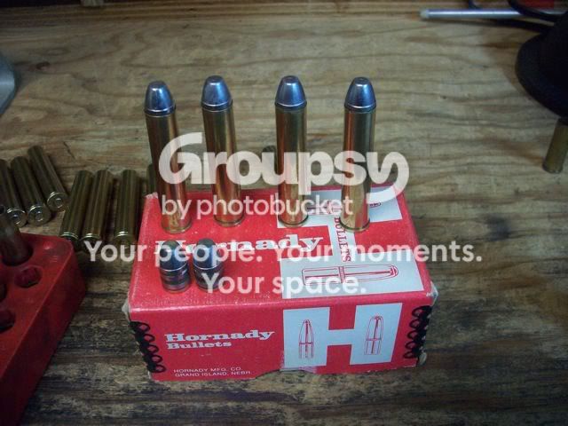

My son wanted to shoot his Marlin more for less so I cast some 250 gr. gas checked bullets for him. It has been a while since I have been casting. Was kind of fun to be doing it again.
250 gr. Gas Checks like this, John Peterson?
You have to seat them quite deeply to stay within the COL

Not quite,;) but here's a quick scan of the two I mentioned earlier.
The one on top is 325gr and the bottem one, 250gr.

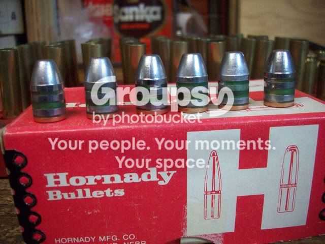

I designed a light weight cast bullet that is hollow point or solid and it works great.
Myself and another member designed this one as a multipurpose bullet with three crimp grooves. Top groove is for .444 Marlin, center is for .44 mag rifle and lower is for .44 mag revolvers. My .444 and .44 mag rifles love this bullet as does my model 629 and redhawk revolvers.
It has taken many animals over the last couple of years.
