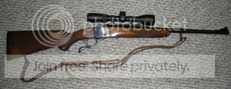

I use the 3rd edition Hornady Handbook data as a reference for my 45-70 Ruger No.1 350gr loads. Using IMR4198 I get 2200+ fps.

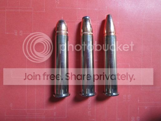

The 350gr TSX has a higher ballistic coefficient (0.28) than the Hornady 350gr RN (0.19) or Speer 350gr FN (0.23) for flatter trajectory and higher downrange energy.
45-70 Ruger No.1-S with Nikon Omega 3-9x40mm scope
