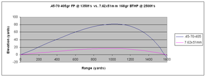

A graph showing the relative trajectories of the .45-70-405 and the 7.62x51 mm/.308 Winchester out to 1500 yards
The main limitation of the .45-70 is the relatively low velocity which puts a practical limit on shots at game beyond 120 meters or so, despite its ability to kill at many times that distance. The trajectory of the bullets is very steep, which makes for a very short point blank range. This was not a significant problem at the time of introduction, as the .45-70 was a fairly flat-shooting cartridge for its time. Shooters of these early cartridges had to be keen judges of distance, wind and trajectory to make long shots; the Sharps Rifle in larger calibers such as .50-110 was used at ranges of 1000 yards[9]. Most modern shooters use much higher velocity cartridges, relying on the long point blank range, and rarely using telescopic sight's elevation adjustments, calibrated iron sights, or hold-over. Sights found on early cartridge hunting rifles were quite sophisticated, with a long sighting radius, wide range of elevation, and vernier adjustments to allow precise calibration of the sights for a given range[10]. Even the military "creedmoor" type rifle sights were calibrated and designed to handle extended ranges, flipping up to provide several degrees of elevation adjustment if needed[11]. The .45-70 is a popular choice for black powder cartridge shooting events, and replicas of most of the early rifles, including Trapdoor, Sharps, and Remington single shot rifles, are readily available.
