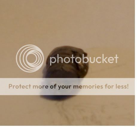

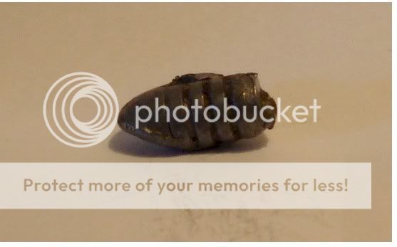

303crabine wanted me to post this...
45-70 cast bullet test out of Marlin 45-70 Guide Gun
420 grain gas checked Green bullet
Chronographed velocity 1630 fps
Shot through 7 railroad ties at 100 yards
Bullet retrieved from 4x4 backstop after bullet hit a large knot and turned sideways.
Bullet weight after losing gas check 377.6 grains
Green bullet
The 420 Gr. "Green " bullet is hard cast and mushrooming is not an occurring ,nor desired feature. Hard cast at this weight and speed will easily go through major bones and continue out the other side of the animal. And as it is already .45 caliber, further mushrooming is generally not required.
However if you cast and want mushrooming.. just fill the nose of the mold with pure lead ..about 75-100 grains worth and add the harder alloy for the bullet shank. Some of these will easily go to just about .55-58 caliber
