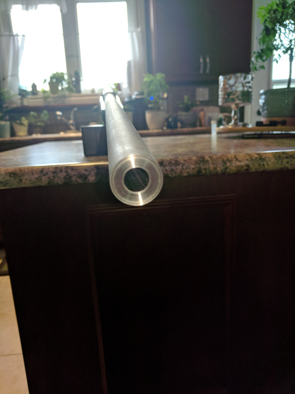

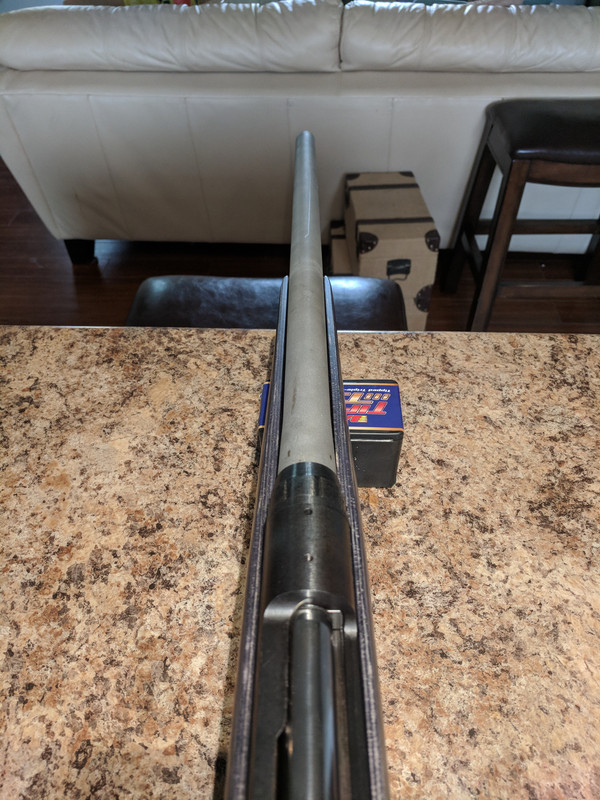

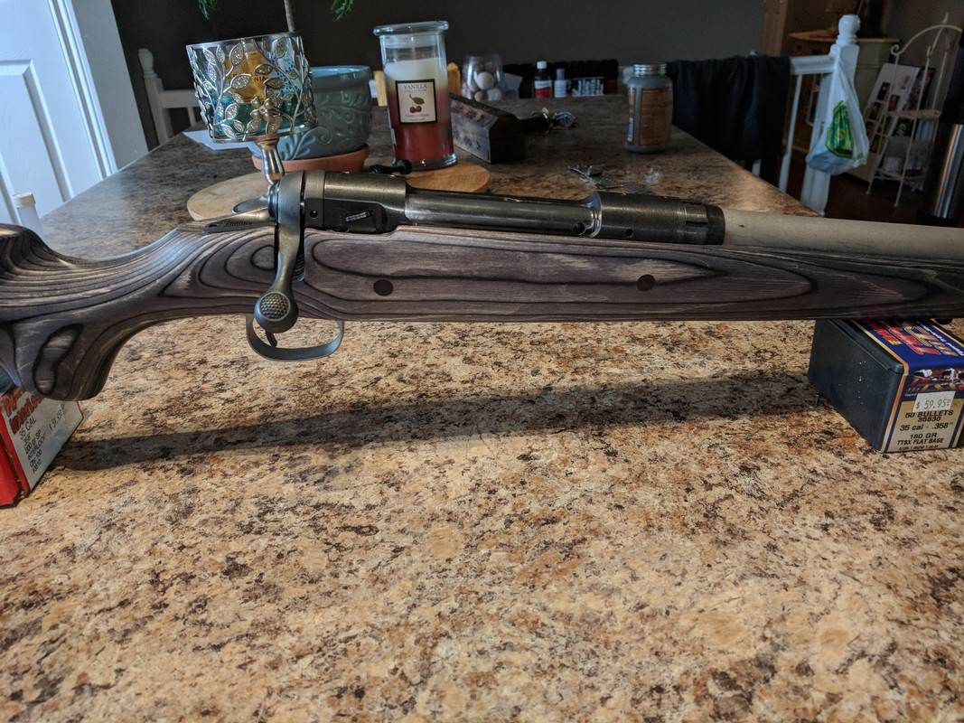

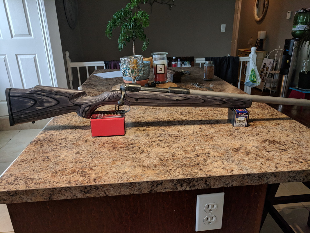

Just wanted to share a cost effective project I have almost completed
I ended up with a spare breech plug made by arrowhead sports in the USA. It uses a module system to allow magnum large rifle primers to fire smokeless, and if so desired sabotless, loads. The smokeless sabotless thing is pretty new but is growing in popularity. Performance and accuracy is close to magnum brass cased cartridge rifles. Bullets are often sized with a section of the rifle barrel used to make a sizing die.
Rifle still needs to go to paint, thinking Matte Black
Shilen Barrel CM blank 300$
Action Savage long Action 0$ (free donation from a friend)
Boyds Stock 200$
Breech Plug and modules 200$
Bit and Pieces 50$
Total 750$
