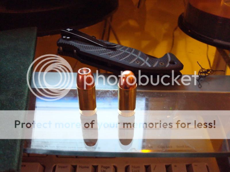

Here's the pics, mine's the Hollow Point, the remington is Round Nose.

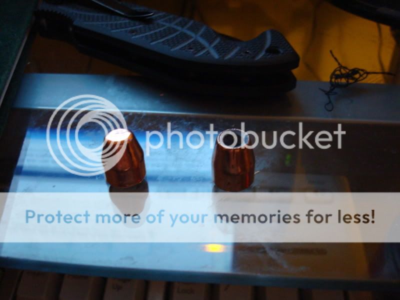

Here's a picture of the bullets themselves to compare, SWC on left, Gold Dot on right.

OK, there seems to be some confusion here that is leading you to the wrong information. The bullet here on the left is not a semi wad cutter (SWC) but just a jacketed flat point. Wad cutters and thus semi wad cutters are designed to cut nice sharp round holes in paper. They will have a sharp 90° angle at the front or shoulder of the bullet to give a nice cut. The bullet you have won't cut the paper any nicer than a round nose bullet.
The Speer manual doesn't show a bullet close to yours for the 45 ACP because they don't make one. This is an excellent reason to get more than one manual by the way. :p
I've been loading 200gr. JFP to 1.175" and would suggest that you start in that area.
