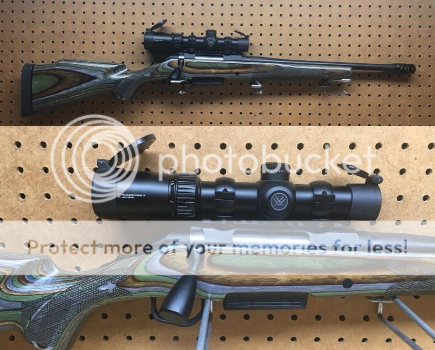

I MADE IT TO THE RANGE!
first off, the 450 does not have a huge amount of recoil. Whether it is all the muzzle brake, or the added weight from the laminate stock, it was easy to handle and not noticeably different than my friends 308 savage axis that we had with us (also a laminate stock).
Did not have a lot of time, so just put one box through it to get it onto paper and dialed in to about 100 yards. groups easily within 2" even with my mediocre marksmanship. Now I just have to carry it around for a day to see how it handles for weight and packing; I expect it be fine for that as well
