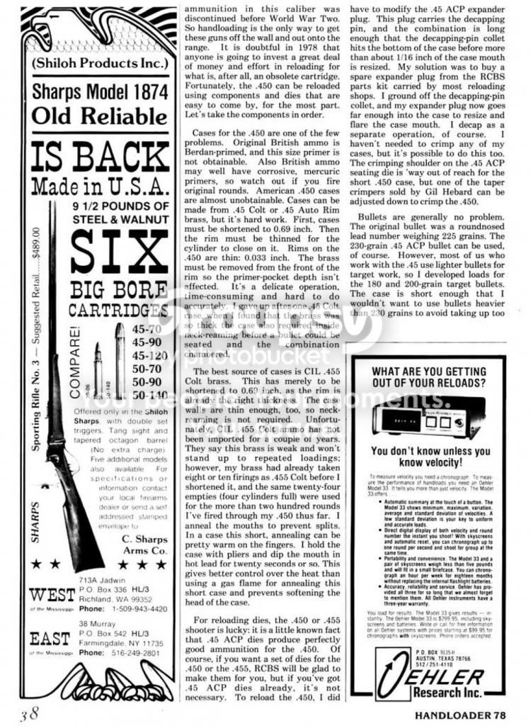

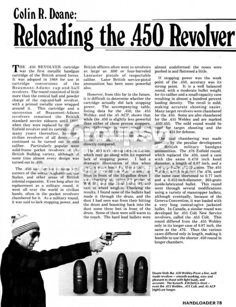

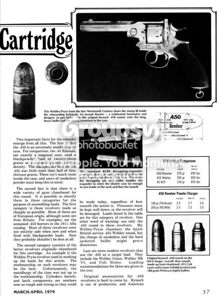

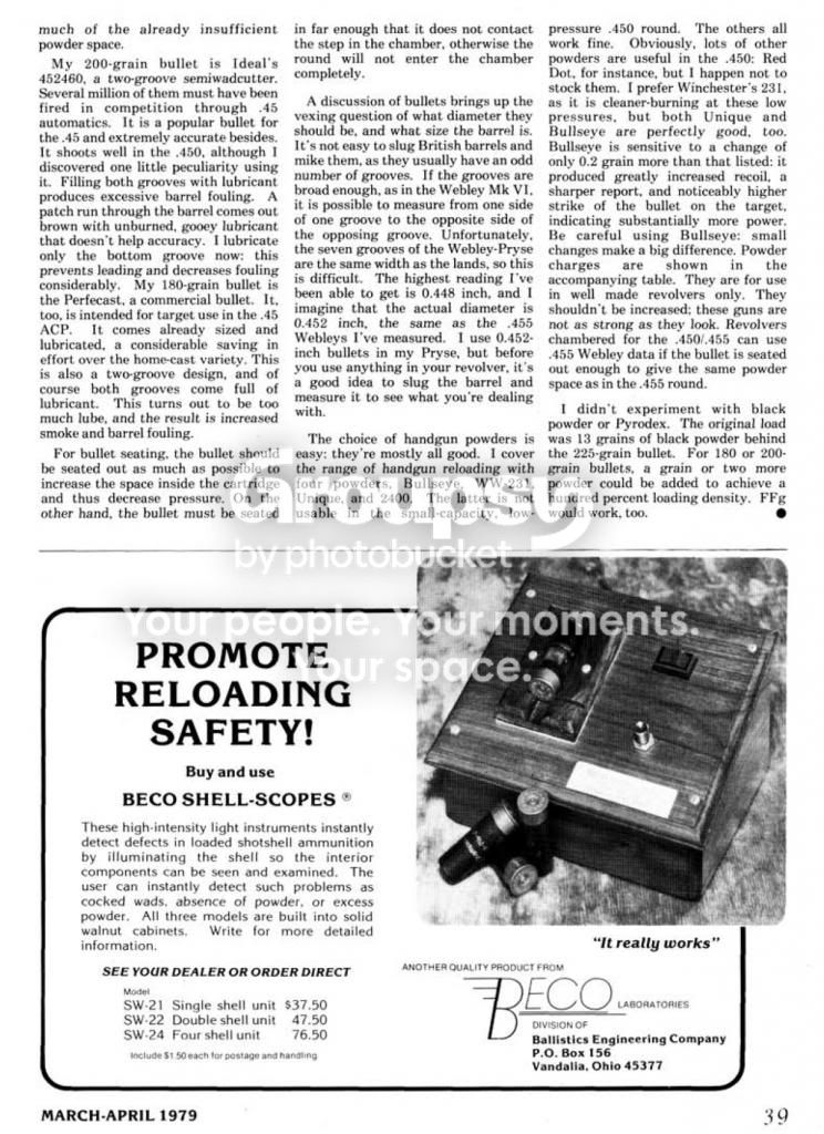

Fascinating.
Thanks for that cyclone.
However, fella's gotta be a masochist to be build'n himself .450 carts. :p
The Pryse?, a very fine revolver indeed.
Actually handled and even fired one once .... a special moment.
The owner had character as well. ;)
