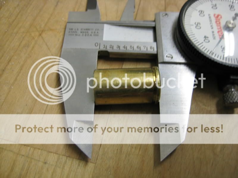

When I worked the lever (harder to do than normal), I found the case had ruptured, leaving about half of it in the chamber:

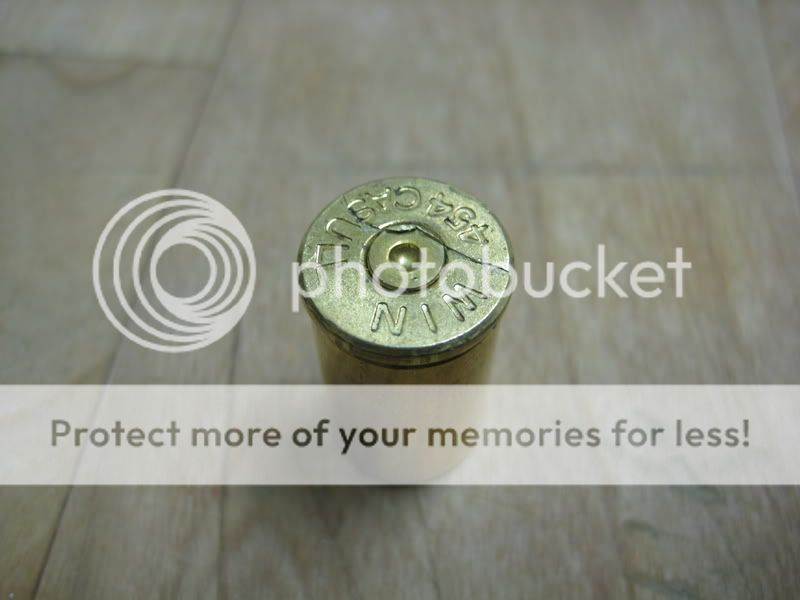

Even more distressing was what I found on closer inspection:

I take it you didn't try a second 454 round in the gun. The only thing that jumps to mind (and I am not an expert at levers at all) is that if you fired a whole bunch of 45Colt (particularly dirty lead loads) and then fired the 454 there may have been deposition in the chamber that caused over pressure problems. That is something that is warned in the revolvers and testing of the issue caused destruction of revolvers, I always scrub out the cylinders of my SRH after shooting a lot of 45Colt.

The 92 Winchester is an immensely strong design, for the cartridges it was intended to fire. I've experienced it myself, when I ringed the chamber of mine with an overload, and did no damage to the action at all. So, I doubt you have damaged the action. However, not all may be as it seems. I suggest you have it checked out to be sure. The Cassul is not a lightweight round. As to the rounds themselves, check with Winchester, see if there is s recall. The Casull is slightly longer than the Colt, and that is supposed to preventit's use in guns designed for the Colt. However, if your chamber was not cut quite long enough, it might still chamber the Casull, even though too short. This would lead to a tremendous pressure build up, and quite possibly a case separation like you experienced. Also, if the bullet is jammed into the lands, it could escalate pressure. Get a chamber cast done, find out if your chamber is long enough for what you are firing.
Then again, if you were shooting a lot of pure lead, you may have a severely leaded bore. Firing a high pressure jacketted round into a severely leaded bore will also raise pressure significantly.

I load about 24 grains of 2400 behind a 250 grain XTp on my 45 Colts if that helps, also, those little Pumas with 454 loads will knock the stuffin's out of ya. They are basically a low powered 45-70. I had problems with the winchester brass splittin in my SRH so I changed to the remington stuff and haven't had a problem since. Les
