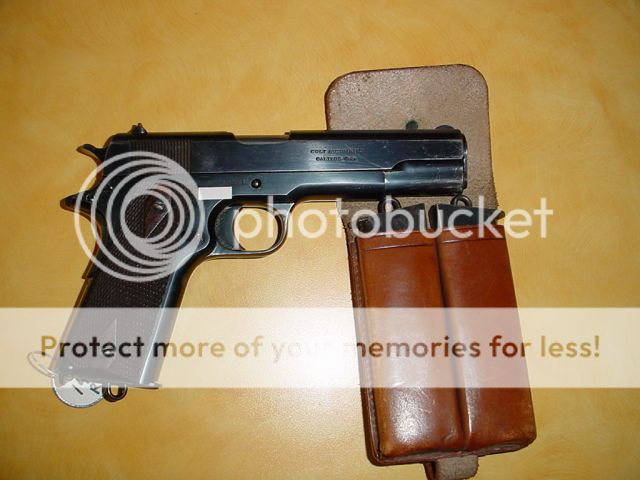

.455 1911 mag pouch
A little off the topic but I have that identical mag pouch with my 1919 mfg. commercial 1911, do you have a picture of the holster that goes with that? gladius 2
