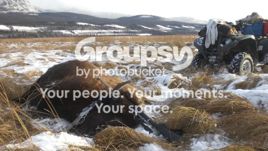

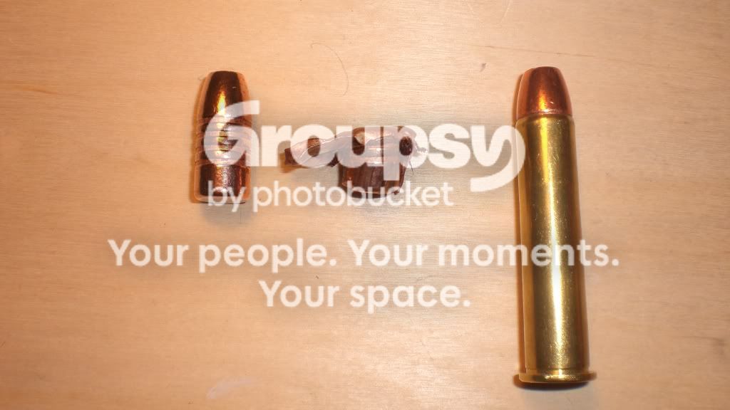

I did get some field results for those who are interested. I took a cow bison in the beginning of November with a single round from approx 125 yards. A quartering shot from the rear. Bullet entered mid neck, through the back of the skull and into the bottom jaw coming to rest just under the skin after punching through the jaw bone itself.
Recovered bullet weigh was 250gr (75% retension) . A few of the pedals broke off butt the bullet held together. Check out the pics
