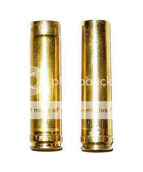

Even a couple or three grains more capacity would be welcomed. I had some great .458 Win loads that were so compressed that they pushed the bullets back out. The compression would get unreasonable just when things were getting interesting. Most published 458 loads for standard weight bullets could be translated as "All the blank powder you can get in the case and still barely seat the bullet". An easier solution than the .458 Improved would have been the .458/300 Win.
