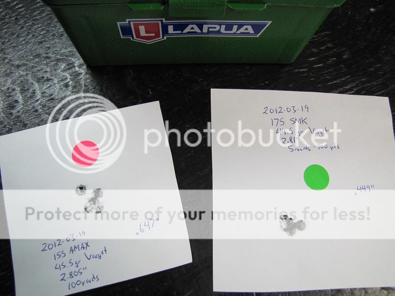

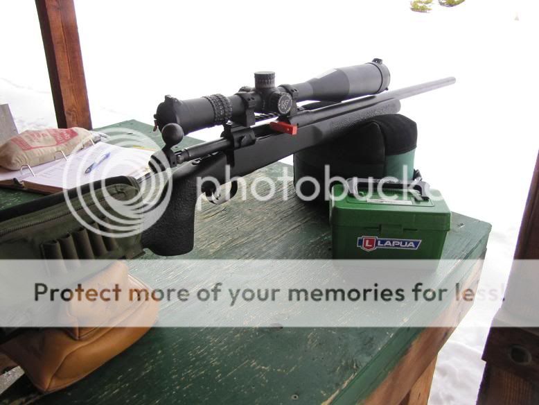

I've always wondered why I shot tighter groups from the prone position vs. bench....until I read the "Hard Hold" article (link below). Since then I've been experimenting with various holds and have found a signficant improvement in group size and shape. I'm running a factory Savage 10 FCP and NF 5.5-22x50.
My Crown land shooting area is snowed-in, thus I've been playing with various holds while shooting off a bench with front/rear bags.
Load data is:
175 SMK
44.5 gr Varget
Win brass
Fed 210
I'm now holding the gun tight. The stock is pulled smartly into my shoulder, the tips of the fingers of my shooting hand lightly grasp the stock while the lower parts of my fingers (area under the first knuckle) pull the rifle towards me. My cheek is planted firmly on the stock. My thumb rests on the tang - slightly off-center of the gun. This combination seems to yield the best results. I think this Hard-hold style bench shooting is very similiar (in how the rifle recoils) as my prone style.
This is quite the opposite to my Savage 12 BVSS in 223 that acts like a prissy little BR gun and likes to nearly free-recoil to achieve best results. Now I know
Lapadat
**The dots are 3/4" and can be found at Walmart - cheap and easy targets**
http://www.canadiangunnutz.com/forum/showthread.php?t=153237&highlight=hard+hold
