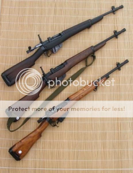

just wondering if someone can explain why some of the #5 jungle carbine's have a metal nose cap, seems like there are more of them without it. I personally like the look of the metal cap, the others look like they just sort of tapered them off with no real style.
I believe they found that over time the early capless stocks got pretty dinged up on the front from banging into things. The cap was added for reinforcement.
A lot of it depended on when the stock was made and where the rifle served. In Malaysia for instance rifles were painted under the stock line to combat the rust that occurred in the salt swamps during patrols etc. Also, many stocks were supposedly varnished to protect them from certain elements. Nose caps were removed in similar situations because they got extremely rusty and the wood rotted underneath.
Both types are correct. Personally, I like the fore ends without the nose band. Not that the nose band is a bad idea though.
