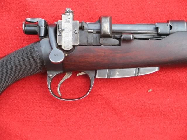

Some of the original 5 round LE mags have a slight fish belly on the bottom and have a slight tail on the bottom of the back of the mag just before the hole in the base.
Most of the flat base ones I have held and seen are not original factory ones and are modified 10 round mags.
This is what I mean by what a original one looks like -
