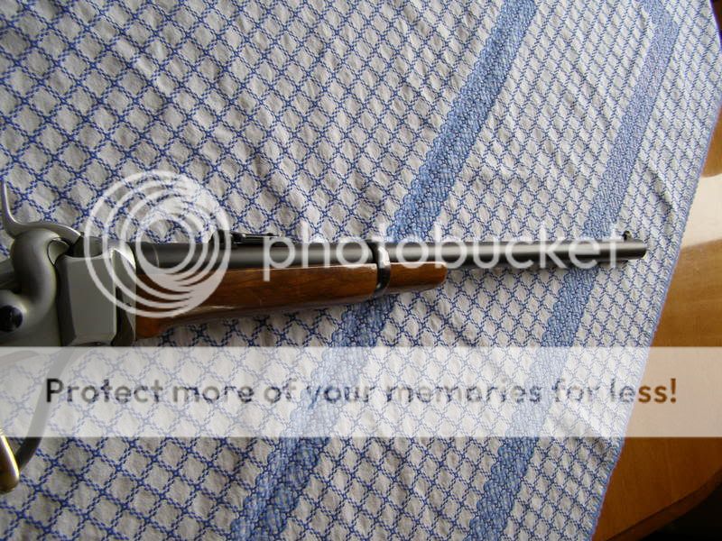

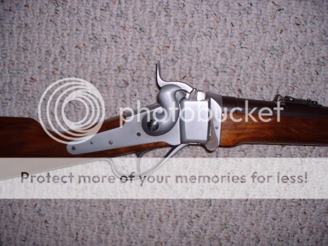

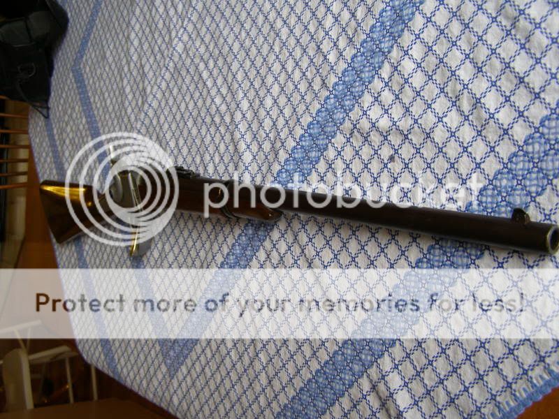

Here's the carbine. I had the action "Metaloyed" here in PG. The shop who did this is not closed down. Although I've re-barreled the action, I kept the original barrel as it's in excellent condition inside, however was re-browned.
New Barrel and forend.
