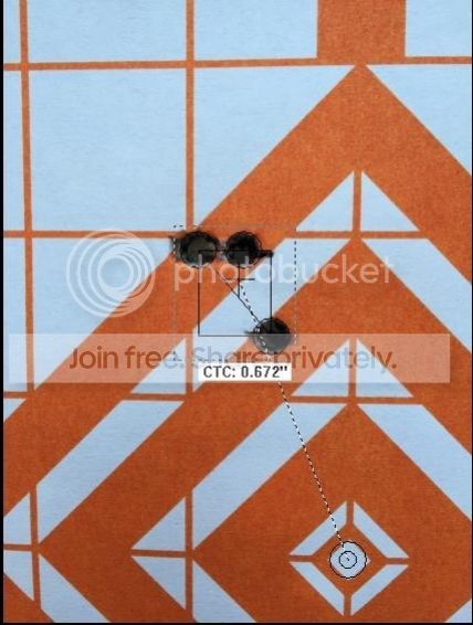

Hi folks.
I'm out of H335 at the moment but I've got some CFE223. I want to work up a new load using Sierra 50 gr bullets for a 700 SPS Varmint. The only data for this powder I can find is Hodgdon's. I plan on working up from book starting load.
Has anyone tried this combo? What worked or didn't? Also, any luck with this powder/bullet combo in 22/250?
Thanks.
I use it and for my rifle, a stiff load of 28 gr with a 50g Hornady spx or sp shoots well with good velocity. There is little copper fouling but it seems to leave a deal of carbon fouling in the barrel which doesn't seem to affect accuracy in my rifle ( a Rem 700 sps sporter weight).
I've used CFE223 with a 55 gr bullet in some 223 Rem loads. Works okay, but I haven't done any serious accuracy tests.
