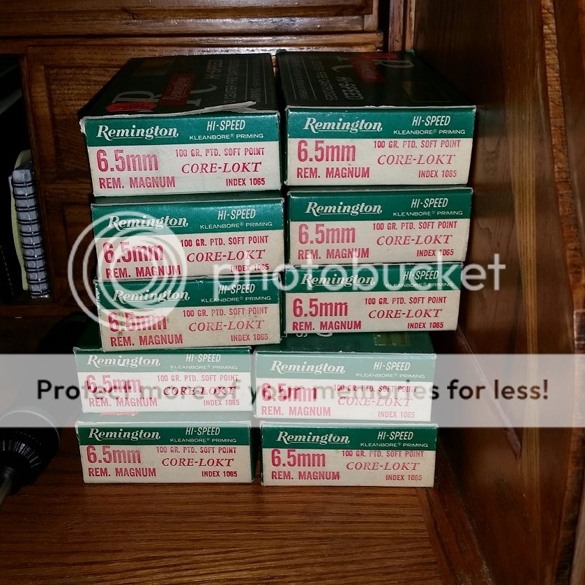

I've been looking for 5 years myself and may have to rechamber too. Just been able to find ammo...

I didn't do anything till I found some ammo, never shot any of it though a I reload since it was finished. Nice stash Shakleford mine are 120's.
