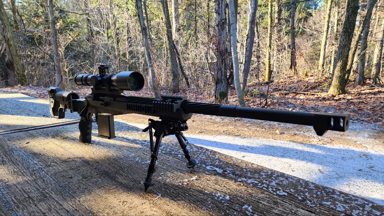

6.5 Creedmoor and keyhole issue
Your stable in a 1-8 twist according to Berger Stability calculator it has a stability of 1.34 at 0 degree, 2650fps. and 0 altitude (anything over 1.0 is stable)
If the first 50 shot fine i would check your muzzle brake to see if you hit the baffles.
testing
take off the brake and shoot them again
