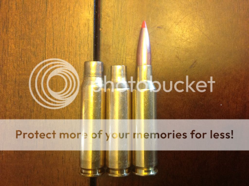

What would be the procedure to form 6.5 CR from 22-250 and what tools are needed?
I also have a good quantity of .308 win norma brass, would it be more work to form 6.5 from it?
Thanks
Pic forming 6XC brass but the process is the same... left to right.
Bump the shoulder so the case is a snug fit in the chamber when the bolt fully closes.
Fireform using COW method - you will need to research this yourself
Do basic neck and case prep.. You will need to outside neck turn and size neck properly to get rid of any excess brass at the base of the neck.
Load with a bullet and fully form case... you can develop a very accurate load to do this final forming and use this for practise and local matches.
Jerry

Ok, so I finally received my 6.5CM dies and decided to experiment last night. I resized a .308win case using the 6.5CM full lenght sizing die and it went really smooth contrary to what I was anticipating. I then trimmed to lenght and here is the result.
Now I gues I would be at the point of fire forming using the COW method and then normal reloading? Do I need to neck turn?
