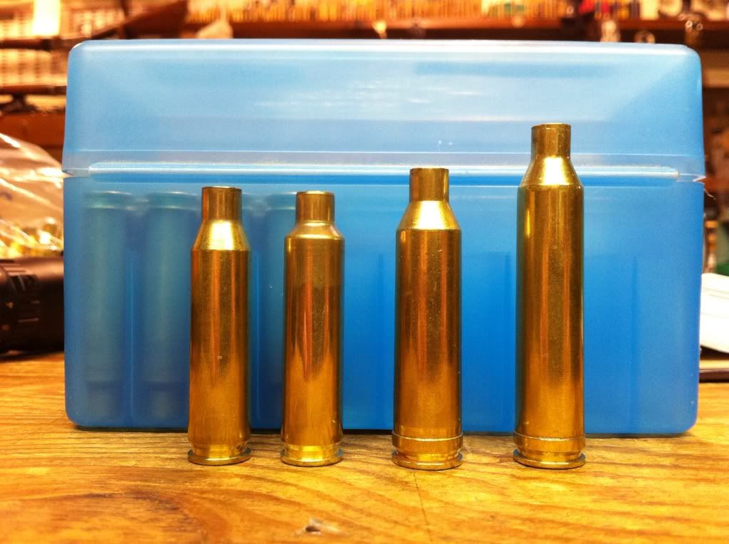

Here is a photo to see some comparison.
Left to right:
260rem, 260AI, 6.5 Rem Mag, 264 Win Mag
