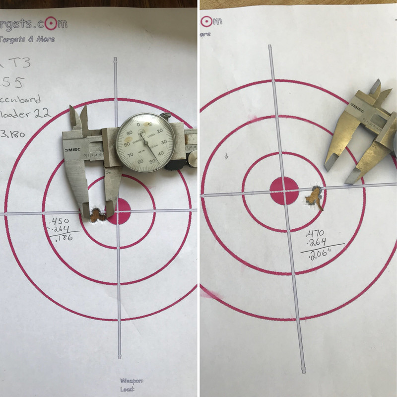

6.5 swede tikka t3 powder and pet loads?
Best groups in three different 6.5 Swedes, to date, were with RL22. 140 gr Sierra Gameking bullets. - dan

120 grain Barnes TTSX
Hornady Cases
Federal GM120M Primers
50 grains Reloader 22
3080 FPS Sub M0A
Tikka M695 Hunter with a really long throat, this is a max load and may not work in your rifle, gleamed it from an article in Rifle Shooter from 1997 by Ross Seyfried, most loads in the manuals are low for the old "weaker" Mauser '96's so there's no reason using modern rifles and powders the old Swede can't shoot with the new cartridges.

I use Lapua brass, CCI 250 magnum primers over 51.0 grains of IMR7828sc.
Velocity is just over 2800fps, and if I do my part, 1/2 moa is a consistent grouping at 100 yds.
This is a load I use in my Remington 700 "Classic" with the 140 Partition. [It is on it's 3rd barrel] accurate and 2800+
With the 125 Partition, I use a 50.0 grain charge of AMS 47SB lot 10 [Slower W760] Shot a lot of deer with this load. :)
I have a load developed with the 130 Scirocco II, that I have yet to use on game: 48.5 grains of 100V. It is shooting
right around .6 moa consistently, so I'm sure the deer will hate this load too, lol Regards, Dave.

Yes that Scirocco II 130gr is wicked accurate in my son's T3 pretty much one hole with RE#22..........good retention on impact with deer.

On factory ammo ,I once purchased 5 boxes of Federal ammo loaded with 140gr Partitons for the brass.They shot 1.5" groups at 100 yards.........nothing to write home about in a Win 70 FWT. I bumped the bullet OAL longer just shy of the rifling and bingo now cutting less than 1/2" groups at a sedate 2600fps but accurate.The cannalure is well above the neck.
