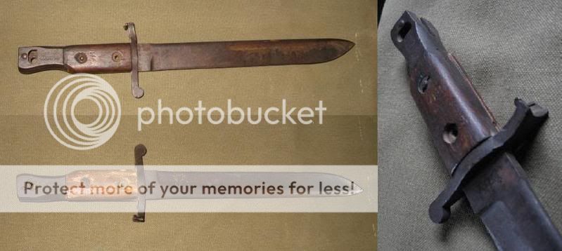

Not exactly gunsmithing but since I could not afford a Ross rifle I found this old wrecked Ross Bayonet.
Then I spent a long time lavishing some loving care on it much the same way a gunsmith does to an old rifle.

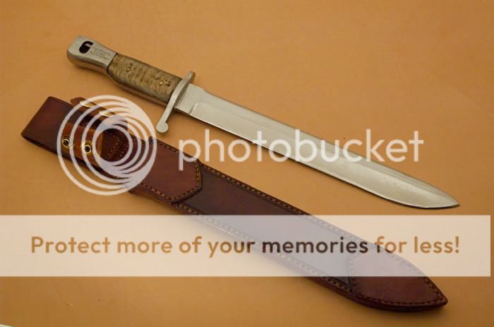

My buddy and forum member SBranson made me an amazing sheath and now I have a beautiful 100 year old
Canadian made bush knife.
Even the bayonets were made with really good steel but were really strange for bayonets.
They had a rounded tip that ended up being ground off in the trenches a lot and a really
nice hollow ground edge that works wonderfully but is really not needed on a bayonet.
It was much more like the butcher knives of the era.
Sorry if I dragged the thread off topic ,I am pretty proud of this knife and take any excuse to show it off.
