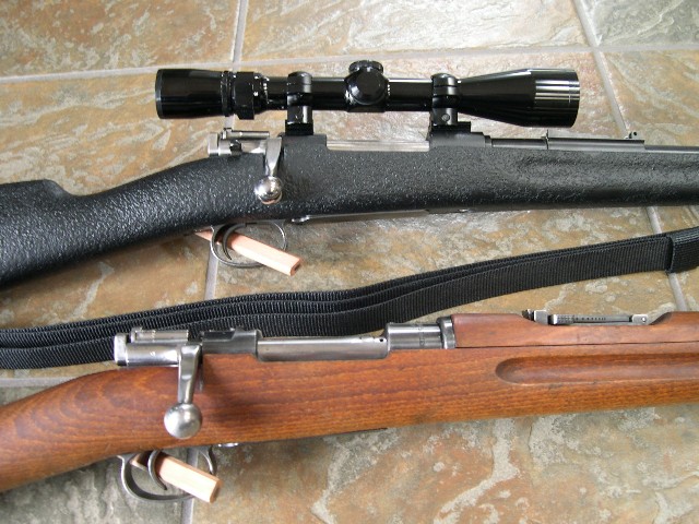

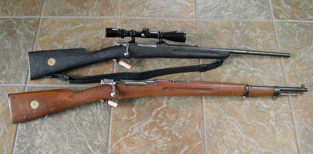

I've never owned a Krag. But I would if a nice full wood un-bubba'd one came along. That said, I've had & currently have some versions of the 1896 Swede Mauser.... Orbendorf, Carl Gustaf & Husqvarna makers of each. All full woods, no sporter of them at this time. The are what they are, accurate, reliable for mil-surps.
If you are looking for a 6.5x55mm as a sporter for hunting, after having gone the sporter Swede route a couple times, knowing what I know now, I'd get a current factory sporter in the ctg. I have a Tikka 695 stainless synthetic in it and there is just no comparision to any Swede 96/38 sporter I've had. I've also had a Ruger 77 MkII and Rem 700 Classic in 6.5x55mm, same thing.
Top: Sporter 96/38; Bottom: M38 full wood.
