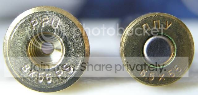

Also, I didn't say I was using Prvi brass. This is cheap Yugo brass I got ages ago from Higginson Powders , back when I could still call them Ammomart. I do have Prvi brass for another caliber and it seems much better than this cheap Yugo brass.
Here's a pic of the brass, Prvi on the left, mistery Yugo brass on the right:

Your mystery Yugo brass IS privi partizan...while under Russian occupation.
The head stamp changed from nny to ppu after they became serbia and non comunist.

PS the "mystery"brass pictured is a 8x56
Thanks a lot for the info ciphery, I certainly didn't know that.
And I think you meant the non mistery (Prvi) brass is 8x56. I know, it's the only Prvi brass I have right now, and the only brass I could find to be able to fire my Mannlicher M95 carbine (I am still looking for a good load for this one, too). It really looks of a much better quality than their old brass, at least the one I got does. And sorry, I have only a couple of pieces of the unfired NNY brass left. The rest I have fired at least once, either in my M96 or my Titan.
