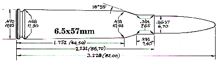

Can 6.5x57 Mauser fit in a rifle chambered for 6.5x58 (Portugese)? (or vice-versa...which sounds more diffcult.)
If so, what harm is there in shooting it?
I have a pre-WWI German sporting rifle supposedly in 6.5x58(Port) and have some reloading info. and dies that came with the rifle. However, on the bottom of the barrel it is marked 6.5 57. I bought some 6.5x57 factory ammo and it chambers very easily.
I am wondering if the previous owners of the rifle may have been mistakenly reloading 6.5x58 (Port) and just cramming it into the rifle which is actually chambered for 6.5x57. (There is no way to contact them.) It certainly seems more likely that a German sporter would be chambered in 6.5x57. There are no marks to indicate re-chambering to the Portugese round.
Anyone have any actual experience with these two cartridges?

You say that the 6.5X57 fits snugly? It drops into the chamber only as far as it should?
Take a 6.5X57 cartridge, prime it, add 10 grs of a fast pistol powder topped with Cream of Wheat and held in place with a toilet tissue "plug". Chamber it against the boltface with extractor over the rim, and fire.
After firing, examine and measure it and see if it still chambers. The shoulder position on the 6.5X58 is slightly forward of where it is for the 6.5X57, so if it blows forward significantly it might not be chambered for 6.5X57.

From the case dimensions, you should be able to fireform useable cartridge cases from 6.5x57 cases
I just took it to the range and shot it with 6.5x57 factory ammo. Shoots fine. I detect no change in the dimensions of the fired cartridge. Good enough for me.

Of course, now that I have established to my own satisfaction that I have a 6.5 x 57 Mauser (as is stamped on bottom of barrel near receiver), I do have a CH 3-die set in 6.5x58 (Portugese) to dispose of...They came with the rifle.
It looks like the dies were expensive. Why anyone would go through the trouble of buying these expensive dies, making brass from .270 Win. and then reloading for 6.5x58 (Portugese) in order to only fire it once (according to the reloading data that also came with the rifle), rather than just shooting factory 6.5x57 (which is still available, here and there, now and again) is beyond me. Especially since it is stamped 6.5 57 on the bottom of the barrel. Possibly they were misinformed by an "expert"? The two cartridges are so similar that a slightly sloppy measuring of a chamber cast could easily result in one thinking it was the Portugese round.
