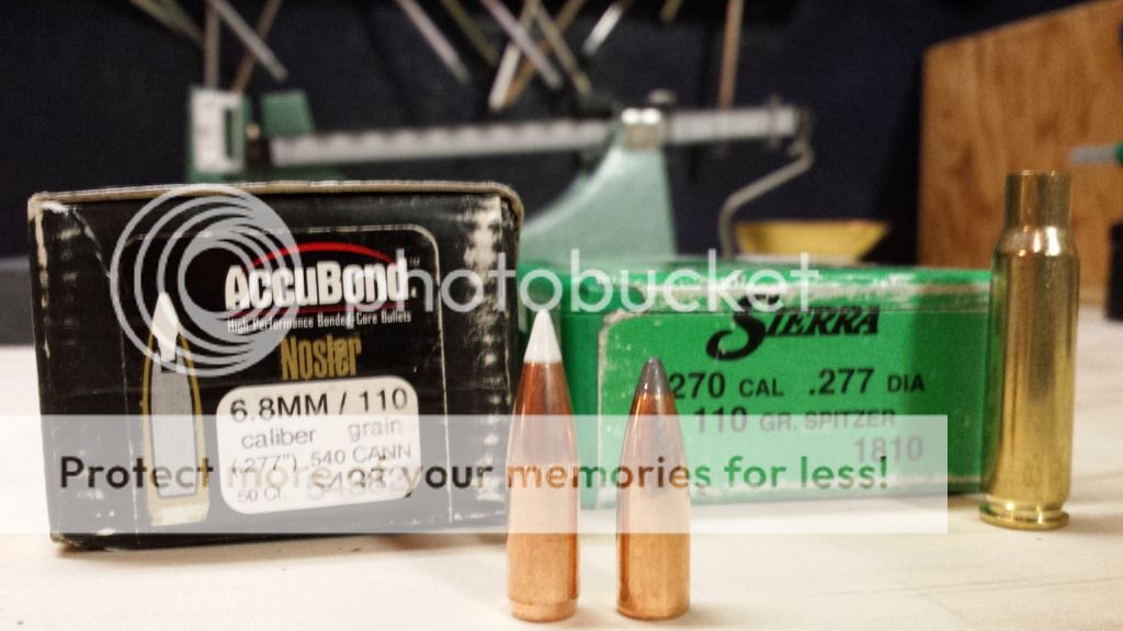

Would you folks think one of these outshines in terms of on deer (whitetail) performance? I'm getting about 2650fps with both of them out of my t/c contender, and accuracy is similar.

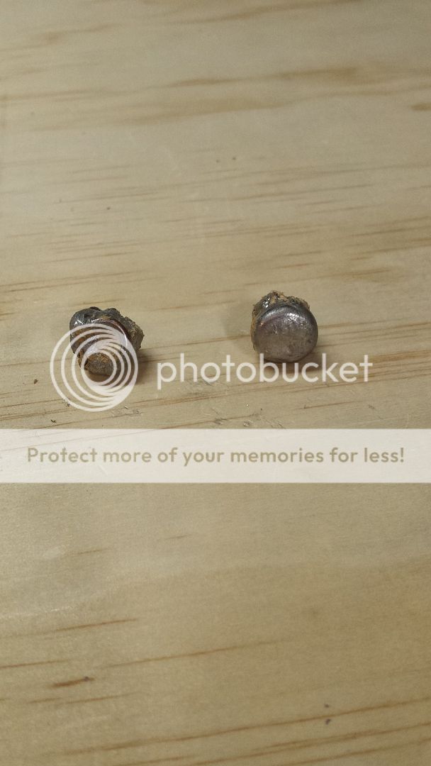

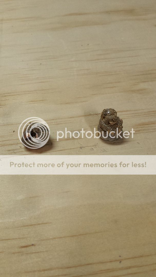

Well I took your advice yodave and shot each into a face of maple. Results were pretty darn close I think. Both had about the same penetration...About 5". The accubond retained 107gr of weight and the sierra 104gr. I didn't go crazy cleaning them so take it for what its worth. Here are couple pics of the recovered bullets, sierra is on left. I am confident both of them would get the job done. What you all think?
