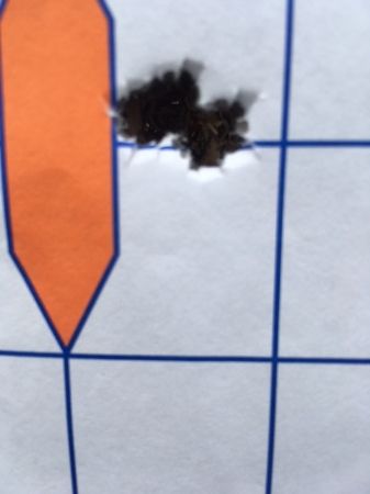

Caliber: .243
Rifle brand: NEF
Rifle Model: Handi-Rifle
Custom built: no
Barrel length and twist: 22 1:10
Projectile brand, model and weight: Hornady 95gr SST
Powder brand and weight: IMR 4831 41gr
LOAD CONSIDERED HOT OR CLOSE TO MAX: Close. 42.5 Hornady's recommended max load. 1.5 gr under.
Primers: Winchester ? Bought them a while ago and threw away the box.
Coal: 2.778
Ogive length:
Brass: Hornady
Brass length: 2.045
Distance to lands: 0.002 off the lands.
Groups under an inch at 100, have yet to try further, need to get a better rest or bipod.

Caliber: 243 win
Rifle brand: Savage
Rifle Model: 10
Custom built: sorta, I installed barrel, chassis is MDT
Barrel length and twist:20"
Projectile brand, model and weight: Hornady 75 g Vmax
Powder brand and weight: Hodgon Superformance
LOAD CONSIDERED HOT OR CLOSE TO MAX: nope, light end
Primers: WLR
Coal: 2.64"
Brass: Federal
Brass length: spec
Results at 100: 0.59"
If available:
Velocity (average): 3279 fps
Outside temperature: 8 celcius
Wind and direction: 5 kph from right
Just tried these out, I did 46 g to 48g loads in 0.5 increments. Three shot groups that opened up as charge increased but I have the best group and most consistent speed at the 46 g.
