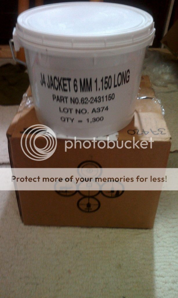

very excited, Goodies have arrived from mystic precision
should make for some nice 6mm bullets.
i foresee a very busy productive winter with lots of fun developing a nice bullet design and weight for my 243 win.

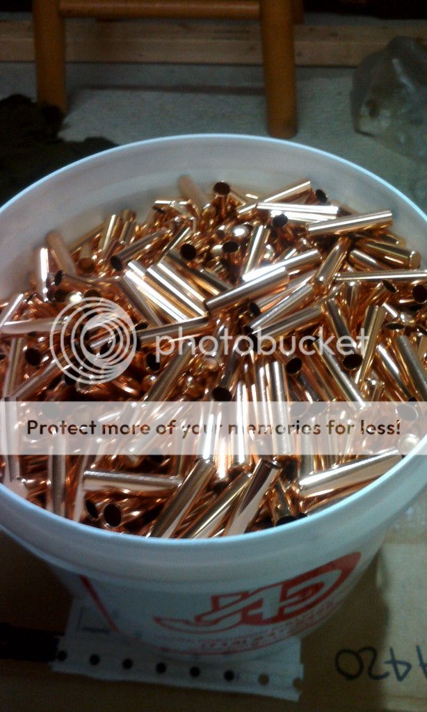

They look long and very pretty:).
Do you have to cut them down to the right length? I don't remember reading about setting the length of the cup.
6 mm J4's come in several lengths.
these are the 1.15 inches long. there is an option to trim them to make shorter lighter bullets but i have plans for these guys... looking to make some long slender rebated boat tail with an s-10 to s12 ogive, haven't decided on final weight yet but it will be somewhere in between 100 to 120 grains... first time tinkering around with longer jackets, im sure i will have lots of calculating and trial and errors and more errors until i find what works well in my gun.
if anyone here has tinkered around with these 6mm long jackets i would appreciate input.
