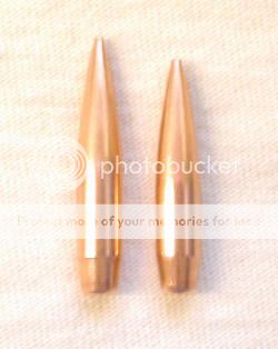

Now if you want a really top tier bullet and have patience, I can now offer JLK bullets. Brand new 115gr and if their QC is like what I have been shooting, these are going to ROCK.
Jerry
swampworks.com/jlk/
go here for full details
Very new slug so no real world BC yet BUT have a look at the pic and decide for yourself.
The 105gr VLD is similar in shape to the Berger so we have a baseline on that variant.
the 115 is a scaled up 105.
Jerry
