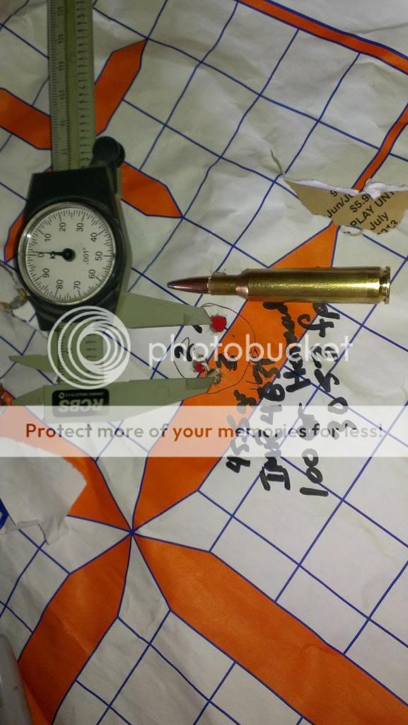

Nice to see a resurrected thread! I settled on 100 grain Sierra ProHunters as the local shop didn't have the Gamekings. I tried 2 powders that performed equally as well - H4350 and H4831SC. Settled on H4350 but would not hesitate to use H4831. If memory serves me correct, I otherwise would have a dime sized 5 shot group at 300yds but had one flyer. I also tend to remember the barrel grouping better after being fouled with at least 10 shots.

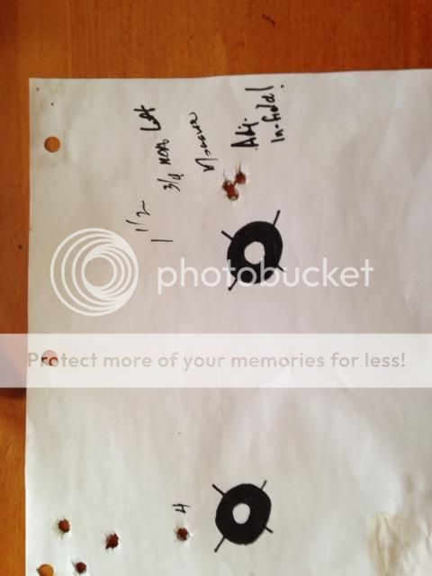

Based on a field test, I have about 7.5" drop at 300 yds with this bullet, so working backwards I think muzzle velocity is in the neighbourhood of 2950 fps. I picked-up a box of 105 grain A-max but I can't get them into the detachable mag on the M788. I plan on some quality time this spring with the 6mm - have another now loaded and shooting spectacular with 65gr V-max. See 200 yd 3 shot group below (and 65 gr Vmax performance):
[URL=http://s863.photobucket.com/user/Remi_08_2008/media/200yd3shotgroup.jpg.html][/URL]
