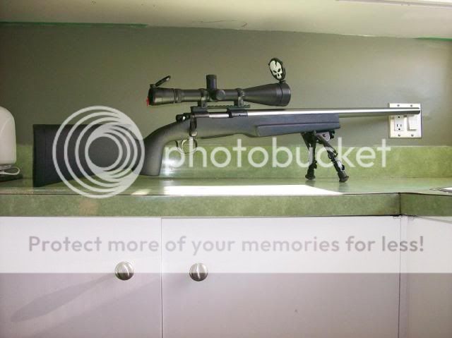

So I guess I will start. probably seen mine already.
Caliber- 6mmBR, Duh
Action- Remmy 700
Barrel- 26" Bartlein varmint contour
Trigger- Stock trigger tuned to 2 lbs
Stock- McMilly A-5
Optics- El-Cheapo Bushy Elite 4200 4-16x40
Rings/Base- More cheap stuff. Burris tactical low with EGW 15 MOA
Accessories- Badger Ord Bottom metal with AI magazine
Hand loading recipe- Lapua brass, CCI 450 primers, 29g varget, 105g Berger VLD about 10 thou into lands
Dies and other reloading accessories- Redding competition die set

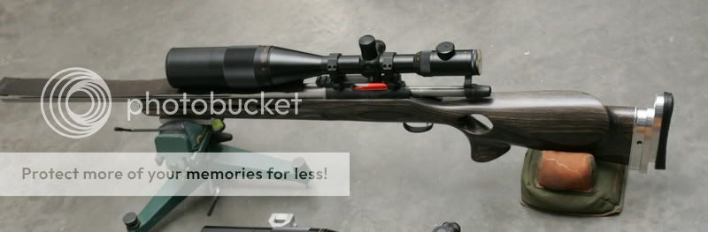

I think everyone has seen these but I'll participate anyway :)
Wine Colored:
Remington XR-100 Action
Remington XR-100 Stock
Jewell HVR @ 6oz
Krieger 1:8 1.25" Dia.
12-42X56 Nightforce BR w/NP2-DD
Farrel 20 MOA Base
Burris Tactical Med Rings
Accurized and built by Mick McPhee
Stock was Stripped, Stained and Finished by Me.
Brown Colored:
Jewell HVR @ 6oz
Krieger 1:8 Heavy Palma Contour
Farrel 20 MOA Base
TPS Med Rings
Pic shows it wearing it's old Smith Barrel 1.25" Straight Blank Fluted
Nowhere near as accurate as my 30WCF tactical precision saddle ring carbine made in 1911, but this will do...
