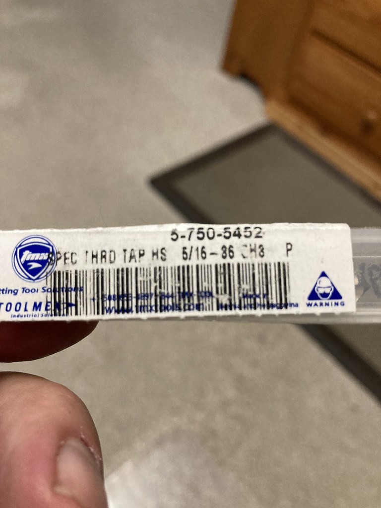

I ordered the tap from Amazon to make my own

^^ this - made my own also. Using your own fired brass from that particular chamber will give the most accurate results.
Hard to say if it made any difference other than with an OCD mind...the 6br's shoot so good.
Tap is 5/16-36
Drill size 9/32. A pilot point or vortex point is easier to use
Corrected - I typed it wrong lol
