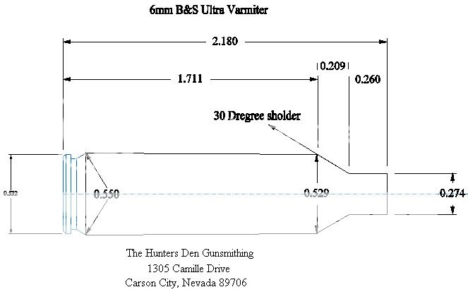

I was wondering if anybody has necked the RUM family down to 6mm or even 6.5. It wouldnt be real great on barrel life but it might be an interesting round to have in the rack. It should be good for really long range targets or deer sized game. I also was thinking of a 9.3 RUM which could be useful for the larger bears and it would be one of a kind.
Any thoughts or problems you can forsee?

The 6mm has been done.
With Wildcats, it's all been done before.
