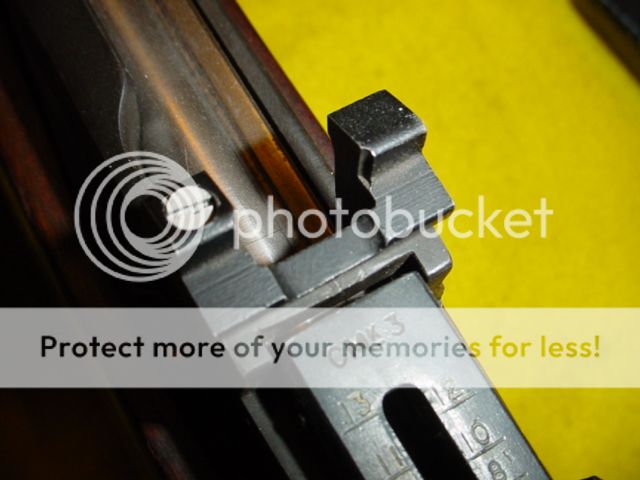

Picked up a book and it had a section on Conversion Kits to convert No.4 rifles to 7.62 repeaters. The kits included a barrel, magazine, bolthead, ejector and stripper clip guide insert to use 7.62 stripper clips. My DCRA rifle I am restoring has everything except the stripper clip guide. So Im wondering how common they were.
Anyone seen one of these?
If anyone has pictures Im particularly interested in the stripper clip guide. If its not too complicated I might be able to fabricate on for mine.
So, anyone seen one?

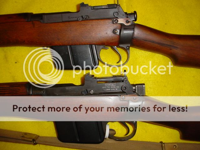

Yes. The Sterling kits had all the bits, including a breeching washer, iirc. The L-42 conversions were similar, but not the same.
I've never seen one of the charger guide inserts, but no doubt one could be made.
I've seen the charger inserts. I had a pic of one on a DCRA rifle but can't find it now unfortunately.
I've had a few of the Sterling mags and a couple of the Enfield mags. Prefer the Sterling mags for smoother feed but something has to be done re ejection. For a Sterling kit a hole has to be bored in the left sidewall of the receiver for the ejector.

The original kits as made by Sterling did not have a snap in charger guide adapter. They had a charger guide that you had to drill and tap to install. The Sterling kit (original) also did not have breeching washers. The kit came with a button type ejector, as Cantom mentioned and you had to drill the receiver to install it. I still have a couple of the kits (unopened) around here somewhere and will see about finding one and opening it up and posting a picture of the contents.
The kits I have came direct from old Major B.B. Keene who was managing director of Sterling back in the 80's.
There was a HUGE patent infringement flap over the conversion kits between Enfield and Sterling and by the time the law suit ended the need for them was gone as the FN rifle was in full production. The remaining kits in stock at Sterling were sold off to Ceylon (Now Myanmar) and the Enfield kits disappeared into the UK woodwork and were sold off by a few gun shops in the London area.
The Enfield kits had breeching up washers and with so little known of the kits there a bit of confusion on who used the breeching up washers.
The Enfield kit had the snap in charger guide. I'll dig one out and post a picture of that as well.
