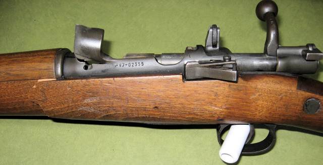

A well used 7.62x51 Mauser followed me home last nite and after a quick google investigation I discovered I may not want to feed it commercial spec .308 ammo...

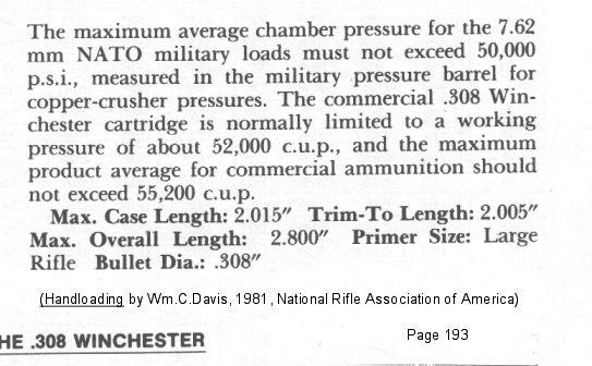

Before we get into a kerfuffle about 7.62 NATO vs. .308 Win. pressures - here's the straight dope from a reliable source:

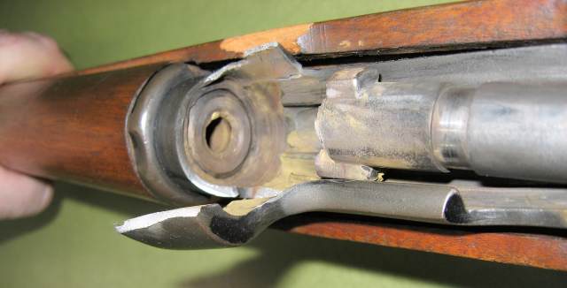

These pics are the reason I bought an FR8 instead......
No details on the pics at all... sorry... I suppose the guy could have purposely destroyed the gun with a super hot load, or a crazy bore obstruction?? But...
No fear mongering here by me. I just don't know if we have all the evidence on the Spanish .308s converted from 7mms yet.

If the brown deposit I see on the blown up rifle is vaporized brass, i would guess it is another rifle blown up with ball pistol powder when he intended to load ball rifle powder. A fairly common accident. 100,000+ psi will do that.....
