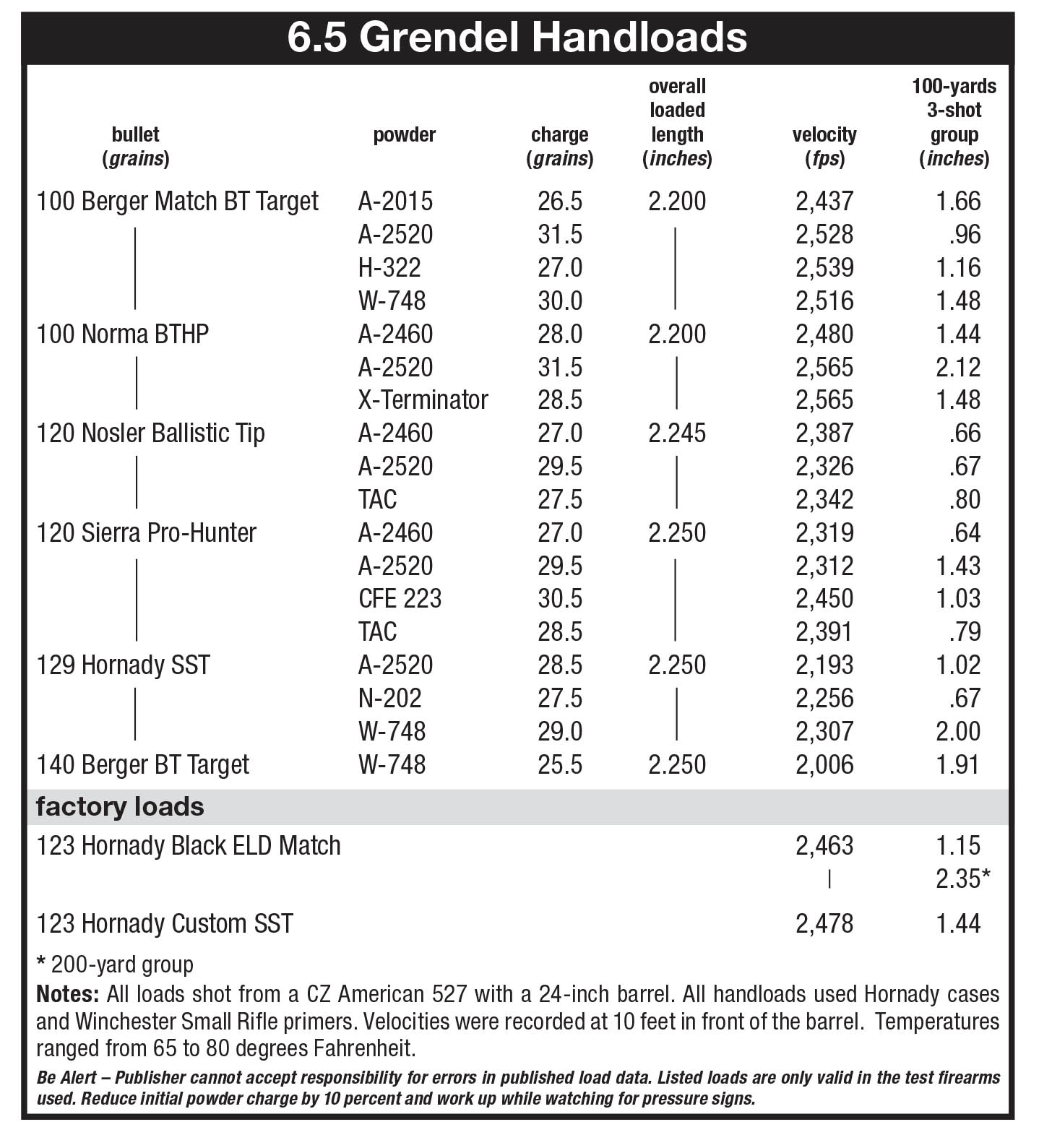

For the Grendel, what would be a good bullet? I do have the 2017 Hodgson reloading magazine that lists a 120 gr. Barnes TSX, I did find this.
https://www.handloadermagazine.com/6-5-grendel-handloads
Seems that the 120 gr. Nosler BT was the most accurate in his gun. Are their any other bullets and powders that might work just as good? Are there and vihtavouri powder that might work? The brand seem to be more available and a little less money then others I've seen?

I'm sorry, I've never loaded lead SP hunting ammo for the 7.62x39, but AA1680 and RE 7 have done very good for me in that round. Just starting to use CFE BLK. The other classic for that catridge is H4198/IMR4198.
For brass I've used both PPU and Winchester and both have done fine.
On the 6.5 Grendel, the 100gr TTSX seems to open very well at Grendel velocities. The ones published there are way slow. Might be AR pressure loads and not bolt gun pressure loads? Check out the Barnes Technical Data section of their website you can likely step those up.
They make a 115gr Tac-TX with a decent (.386?) BC that is supposed to be optimized to Grendel speeds.
