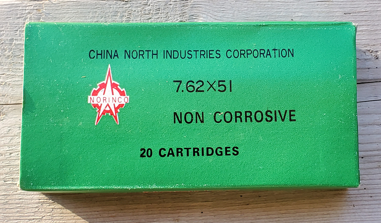

Now that M1As and their clones are deemed evil what do I do with this commie stuff?
How safe is it to shoot out of a modern .308 bolt-action?
Is it steel cased? If so will it cause extra chamber wear?
cheers
It is safe to shoot. Copper washed steel case. I think you would have to shoot an awful pile to wear a chamber, but what do I know. I shoot the stuff in my Israeli Mausers.
Hmm.. I'm reading conflicting info on these. The retailer they were purchased from and a few CGNers stated they were copper-jacketed FMJ.
..but how does that explain this?

Just to be sure I'll pull one bullet, section it and have a look. I probably should have done it before posting.
Any first-hand experiences on how non-corrosive this stuff is?
This is confusing. Your op was about wear in the chamber from steel cased ammo. Whether the core of the bullet is steel or lead has zero bearing on wear. No need to section it.
Maybe I did phrase it confusingly, sorry.
Since I can't use this ammo for it's intended purpose (firing through an M1A/M305), I'm wondering whether or not it's a good idea to fire it through a decent bolt action for plinking - especially with ammo prices the way they are now.
I just sectioned it and there's definitely no steel core, just solid lead.
The jacket is a very thick ferrous metal with a copper coating/wash that is so thin you can almost scratch it off with a fingernail.
It's regular run of the mill copper washed steel jacket, hence why the magnet sticks to it, And as you discovered lead core. the case is also copper washed steel.
Iam surprised someone suggested it was steel core. You don't see it often on 7.62x51, but you see it lots on 7.62x39.
