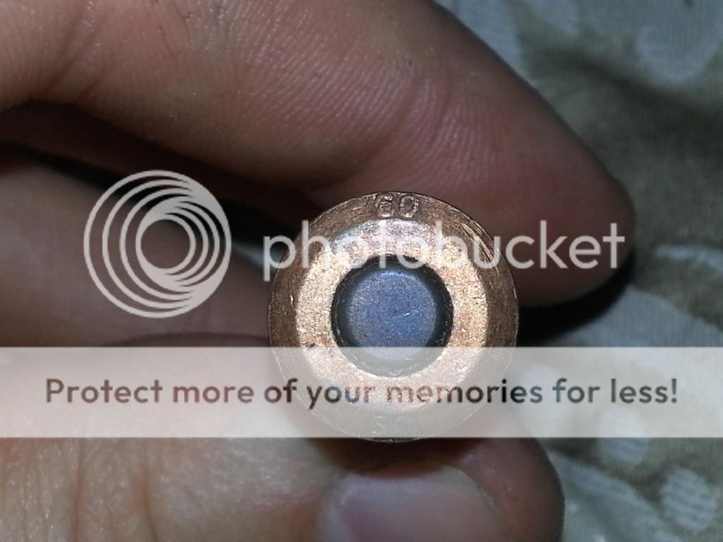

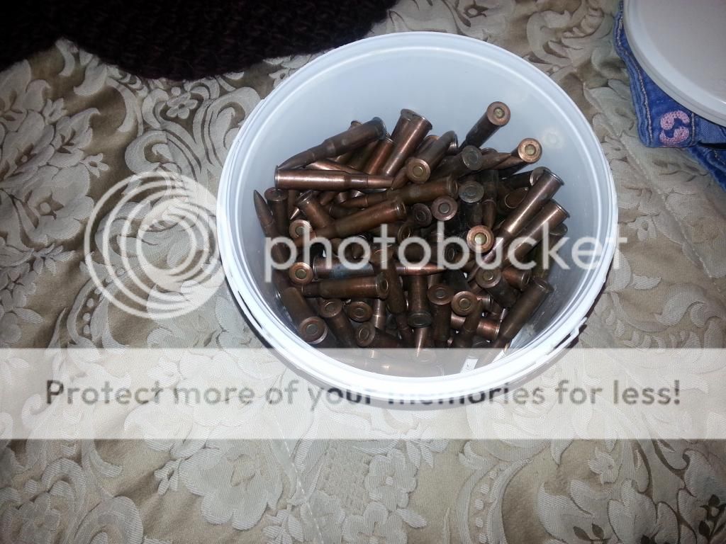

Hello.
A friend at church recently gave me a MN 91/30, and this morning showed up with some old ammo. Some has turned a little tarnished, some are a little "green".
I intend to shoot what I can of it, but would like to know more about it. I am 99.9% confident it is corrosive. Most of the head stamps are 60-50 and others are 60-47.
is there anyone here who knows about these head stamps, or where they came from?

According to h ttp://cartridgecollectors.org/?page=headstampcodes they were manufactured at Russian State Factory at Frunze, Kirgisia, Russia in 1950.
Yup, Rifleman's got it. Sounded like old surplus right from the start. That'll likely mean 174 grain, steel core FMJ, and definitely corrosive.

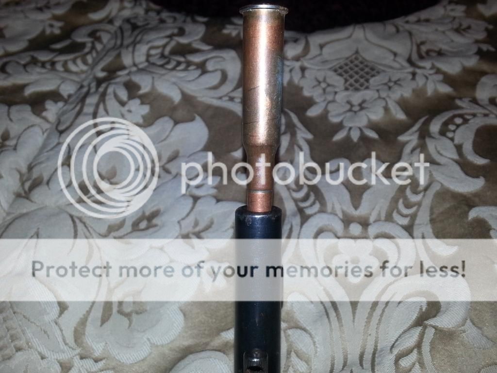

Honestly, this is the first rifle I have ever had that I am a bit nervous to shoot. Just something about it. I think I may either remote shoot or hip shoot it the first couple times just to be sure. I want to shoot it though.
The rifle was a little rusted when I got it, I spent several hours cleaning it with steel wool and oil. The barrel is pitted, and took a lot to clean out. Maybe I will post a pic of it too. It all matches except the bolt.

The gun is fine I have the same thing not to long ago. I found a mosin laying in my basement that's been collecting dust for over 10 years, was given to my dad as a gift. I cleaned it all out...checked the head space with the bolt tool it came with and thing fired like a beaut...really accurate too. Mosin Nagants are bullet proof it's reallly hard to ruin them.
