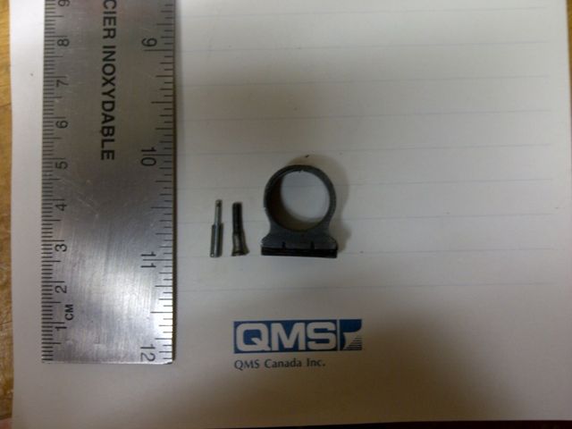

I think the 54r cartridge will take out anything from vaporizing a squirrel to elk. As for raising your POA to match POI try making a new front sight post.
I made one for my M44 using a small common nail and a piece of split pin spring. Paint it flat black and file it down until you POI comes up. This way you don't have to file down your original front post and you end up with a narrower front post.

Most mosins shoot a bit high without the bayonet when shooting surplus 150gr ammo, but less high with the 203gr soft points. I compensate by adding a piece of heat shrink or wire insulator to the front sight to add a milometer, then slowly clip it down to center your shots. There are several longer/higher front posts you can purchase, and they work well too.

You can make a new front sight post using a finishing nail. I measured how tall I wanted it to be, stuck it in the drill press and made it into the shape I wanted using a file.
