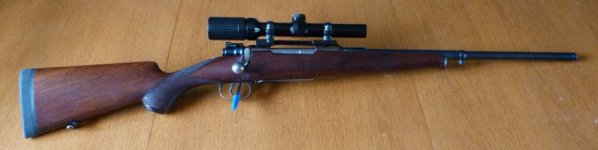

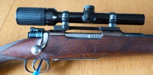

I apologise for my poor photography skills, but here is mine. I've yet to get the 4th scope base hole D&T'ed as I abhor 1 piece Leupold mounts, reinstall one of my rapidly diminishing supply of banded sling swivels, as well as install open sights on the carbine-length 19" barrel. I used one of my spare Husqvarna Model 146 stocks in place of the sporterised military stock that was on it when I bought it. Somewhere in its previous life, the hinged trigger guard & floor-plate assembly was removed & a military one was installed in its place. As befits its bob-tail barrel, one of my Bausch & Lomb BALVAR 1.5-6x20 scopes was installed. I also have yet to hollow out the butt as it is quite rear heavy as a result of the short barrel. At some point, the fore-end will be shortened & an ebony fore-end tip will be installed, at which time the stock will be re-finished with Danish oil.
Its favourite jacketed loads are PPU brass, pretty well any non-magnum LR primer, an equal load of 48.0 grs. of any of Alliant Reloder 15, Hodgdon's Varget or some of my remaining stash of IMR4320 behind the Western [marketed by Cam-Pro] 180 grain RNSP bullet, or 21 grs. of Nobel Magnum 6 behind my 206 gr. hard cast BRTORNFPGCTL bullet from NOE's 314299 mould.

Nice. Gotta love those old Mausers. - dan
